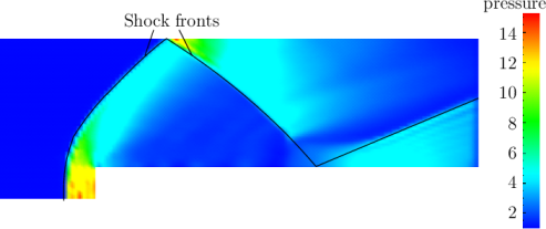

The case approaches a steady-state at some time after 10
. The results for
pressure at 2
are shown in Figure 3.5. The results clearly show discontinuities
in pressure, i.e. shock waves, emanating from ahead of the base of the step.
