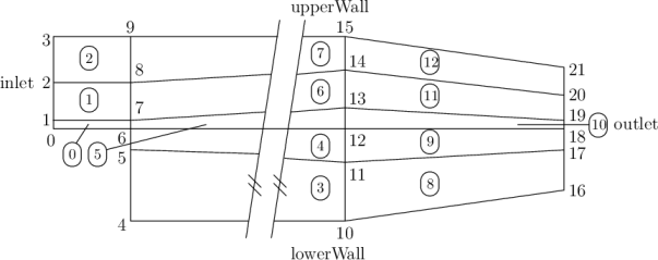

The domain is subdivided into 12 blocks as shown in Figure 3.2.
The mesh is 3 dimensional, as always in OpenFOAM, so in Figure 3.2 we are
viewing the back plane along
. The full set of vertices and blocks are
given in the mesh description file below:

A major feature of this problem is the use of the full mesh grading
capability of blockMesh that is described in section ?? of the User Guide. The
user can see that blocks 4,5 and 6 use the full list of 12 expansion ratios.
The expansion ratios correspond to each edge of the block, the first 4 to
the edges aligned in the local
direction, the second 4 to the edges
in the local
direction and the last 4 to the edges in the local
direction. In blocks 4, 5, and 6, the ratios are equal for all edges in the local
and
directions but not for the edges in the
direction that
corresponds in all blocks to the global
. If we consider the ratios used
in relation to the block definition in section ?? of the User Guide, we
realize that different gradings have been prescribed along the left and right
edges in blocks 4,5 and 6 in Figure 3.2. The purpose of this differential
grading is to generate a fine mesh close to the most critical region of
flow, the corner of the step, and allow it to expand into the rest of the
domain.
