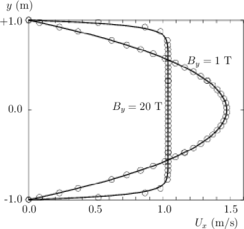

Consequently with the flow fairly steady at
the velocity profile
is almost planar, viewed at a cross section midway along the domain
. The user can plot a graph of the profile of
in dxFoam.
Now the user should reduce the magnetic flux density
to 1
and re-run
the code and Ucomponents. In this case,
and the electromagnetic body
forces no longer dominate. The velocity profile consequently takes on the
parabolic form, characteristic of Poiseuille flow as shown in Figure 2.19. To
validate the code the analytical solution for the velocity profile
is
superimposed in Figure 2.19, given by:
