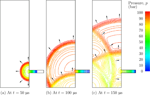

The user can run the case and view results in dxFoam. The liquid flows out through the nozzle causing a wave to move along the nozzle. As it reaches the inlet to the tank, some of the wave is transmitted into the tank and some of it is reflected. While a wave is reflected up and down the inlet pipe, the waves transmitted into the tank expand and propagate through the tank. In Figure 3.7, the pressures are shown as contours so that the wave fronts are more clearly defined than if plotted as a normal isoline plot.
If the simulation is run for a long enough time for the reflected wave to return to the pipe, we can see that negative absolute pressure is detected. The modelling permits this and has some physical basis since liquids can support tension, i.e. negative pressures. In reality, however, impurities or dissolved gases in liquids act as sites for cavitation, or vapourisation/boiling, of the liquid due to the low pressure. Therefore in practical situations, we generally do not observe pressures falling below the vapourisation pressure of the liquid; not at least for longer than it takes for the cavitation process to occur.

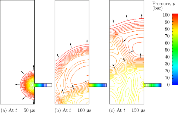

3.3.5 Improving the solution by refining the mesh
Looking at the evolution of the resulting pressure field in time, we can clearly
see the propagation of the pressure wave into the tank and numerous reflections
from the inside walls. It is also obvious that the pressure wave is smeared over a
number of cells. We shall now refine the mesh and reduce the time step to obtain
a sharper front resolution. Simply edit the blockMeshDict and increase the number
of cells by a factor of 4 in the
and
directions, i.e. block 0 becomes
(120 80 1) from (30 20 1) and so on. Run blockMesh on this file. In
addition, in order to maintain a Courant number below 1, the time step
must be reduced accordingly to
. The second simulation
gives considerably better resolution of the pressure waves as shown in
Figure 3.8.
