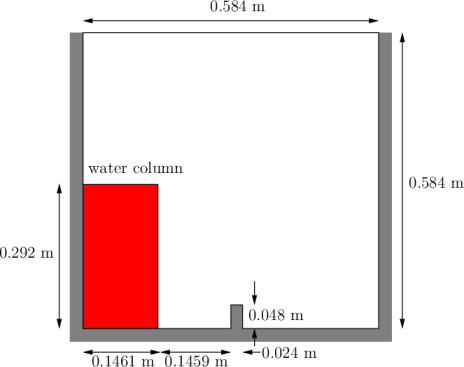

The test setup consists of a column of water at rest located behind a
membrane on the left side of a tank. At time
, the membrane is removed
and the column of water collapses. During the collapse, the water impacts an
obstacle at the bottom of the tank and creates a complicated flow structure,
including several captured pockets of air. The geometry and the initial setup is
shown in Figure 4.1.

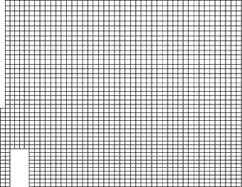

47blocks
48(
49 hex (0 1 5 4 12 13 17 16) (23 8 1) simpleGrading (1 1 1)
50 hex (2 3 7 6 14 15 19 18) (19 8 1) simpleGrading (1 1 1)
51 hex (4 5 9 8 16 17 21 20) (23 42 1) simpleGrading (1 1 1)
52 hex (5 6 10 9 17 18 22 21) (4 42 1) simpleGrading (1 1 1)
53 hex (6 7 11 10 18 19 23 22) (19 42 1) simpleGrading (1 1 1)
54);
55
56edges
57(
58);
59
60boundary
61(
62 leftWall
63 {
64 type wall;
65 faces
66 (
67 (0 12 16 4)
68 (4 16 20 8)
69 );
70 }
71 rightWall
72 {
73 type wall;
74 faces
75 (
76 (7 19 15 3)
77 (11 23 19 7)
78 );
79 }
80 lowerWall
81 {
82 type wall;
83 faces
84 (
85 (0 1 13 12)
86 (1 5 17 13)
87 (5 6 18 17)
88 (2 14 18 6)
89 (2 3 15 14)
90 );
91 }
92 atmosphere
93 {
94 type patch;
95 faces
96 (
97 (8 20 21 9)
98 (9 21 22 10)
99 (10 22 23 11)
100 );
101 }
102);
103
104mergePatchPairs
105(
106);
107
108// ************************************************************************* //

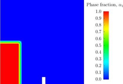

4.1.4 Setting initial field
Unlike the previous cases, we shall now specify a non-uniform initial condition for
the water phase fraction,
, where
![]() | (4.1) |
This is achieved by running the setFields utility. It requires a setFieldsDict dictionary, located in the system directory, whose entries for this case are shown below.

The defaultFieldValues sets the default value of the fields, i.e. the value the
field takes unless specified otherwise in the regions sub-dictionary. That
sub-dictionary contains a list of subdictionaries containing fieldValues that
override the defaults in a specified region. The region is expressed in terms of a
topoSetSource that creates a set of points, cells or faces based on some
topological constraint. Here, boxToCell creates a bounding box within a vector
minimum and maximum to define the set of cells of the liquid region. The phase
fraction
is defined as 1 in this region.
The setFields utility reads fields from file and, after re-calculating those fields, will write them back to file. Because the files are then overridden, it is recommended that a backup is made before setFields is executed. In the damBreak tutorial, the alpha.water field is initially stored as a backup only, named alpha.water.orig. Before running setFields, the user first needs to copy alpha.water.orig to alpha.water, e.g. by typing:
cp 0/alpha.water.orig 0/alpha.water
The user should then execute setFields as any other utility is executed. Using paraFoam, check that the initial alpha.water field corresponds to the desired distribution as in Figure 4.2.

The results from the previous example are generated using a fairly coarse mesh. We now wish to increase the mesh resolution and re-run the case. The new case will typically take a few hours to run with a single processor so, should the user have access to multiple processors, we can demonstrate the parallel processing capability of OpenFOAM.
The user should first make a copy of the damBreak case, e.g. by
cd $FOAM_RUN/tutorials/multiphase/interFoam/laminar/damBreak
mkdir damBreakFine
cp -r damBreak/0 damBreakFine
cp -r damBreak/system damBreakFine
cp -r damBreak/constant damBreakFine
blocks
hex (0 1 5 4 12 13 17 16) (46 10 1) simpleGrading (1 1 1)
hex (2 3 7 6 14 15 19 18) (40 10 1) simpleGrading (1 1 1)
hex (4 5 9 8 16 17 21 20) (46 76 1) simpleGrading (1 2 1)
hex (5 6 10 9 17 18 22 21) (4 76 1) simpleGrading (1 2 1)
hex (6 7 11 10 18 19 23 22) (40 76 1) simpleGrading (1 2 1)
As the mesh has now changed from the damBreak example, the user must
re-initialise the phase field alpha.water in the 0 time directory since it contains a
number of elements that is inconsistent with the new mesh. Note that there
is no need to change the U and p_rgh fields since they are specified as
uniform which is independent of the number of elements in the field. We
wish to initialise the field with a sharp interface, i.e. it elements would
have
or
. Updating the field with mapFields may produce
interpolated values
at the interface, so it is better to rerun the
setFields utility. There is a backup copy of the initial uniform
field named
0/alpha.water.org that the user should copy to 0/alpha.water before running

with refined mesh.
